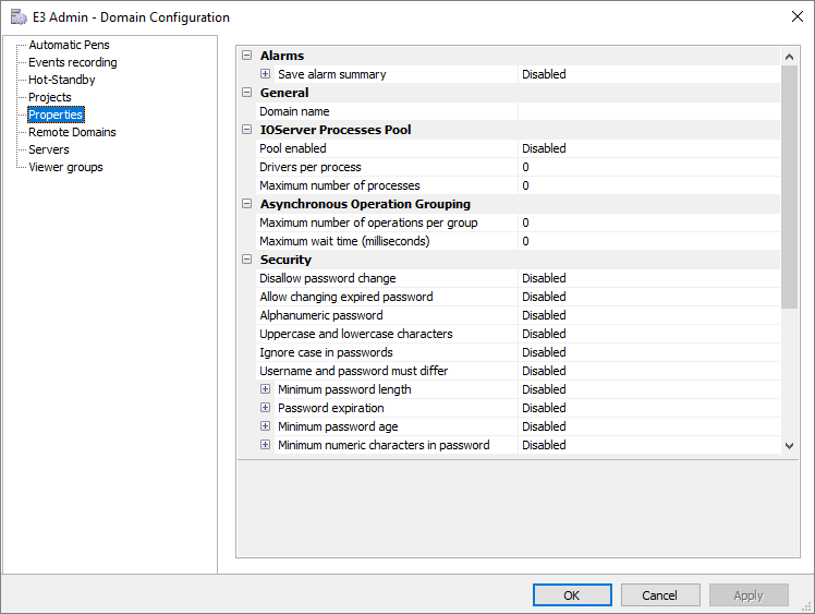

Properties Tab |
Allows controlling various Domain configurations. To open this item, right-click the E3 Admin icon on Windows Notification Area, select the Domain - Options
option to open the window on the next figure, and then click the Properties tab.
Properties tab
The Alarms group contains the Save alarm summary option, which allows saving the alarm summary and therefore avoiding duplicated alarm notifications when opening or closing a Domain. By default this option is disabled. To enable it, select the Enabled option on the Enable item and specify a time interval, in minutes, in the Time interval option. The default time interval of this option is 1 (one) minute. These saved alarms are loaded whenever a Domain is opened and saved in the interval specified in the Time interval option or whenever a Domain is closed. Saving alarms is not performed when stopping or executing a Domain, because the alarm summary is kept in memory.
