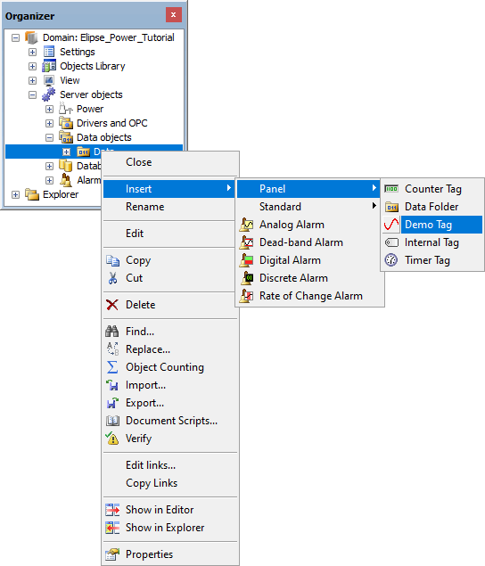

1.In Organizer, select the Server objects - Data objects - Data item.
2.Insert a Demo Tag named "Clock".
Add Demo Tag

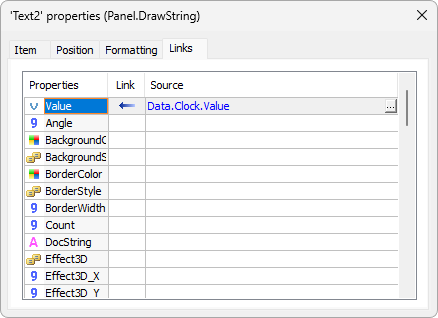

6.Select the Links tab. In the Value property, use the AppBrowser to select, on Source column, the Demo Tag Clock (in Server objects - Data objects - Data). On the right, select the Value property and click Paste. Information goes from Tag to Display, therefore this is a Simple-type Link (Property « Source).
