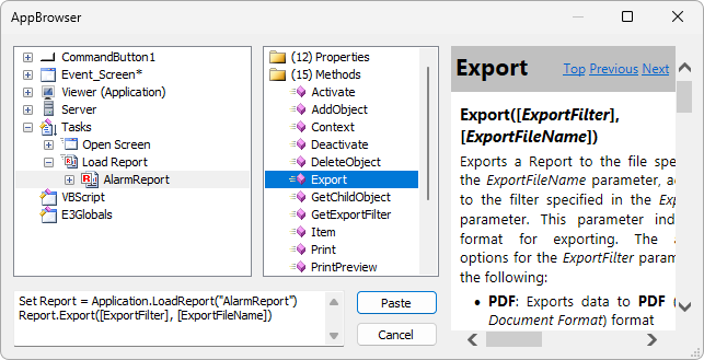

3.Use the AppBrowser to select Report's Export method. Notice that this method's parameters are explained on Elipse Power Reference and Scripts Manual, which is opened on the AppBrowser interface itself, on the right.

4.Paste and adapt this script, which must be configured according to the next code.
Sub CommandButton2_Click()
  Set Report = Application.LoadReport("AlarmReport")
  Report.Export "EXCEL", "C:\Elipse_Power_Tutorial\ReportExcel.xls"
End Sub
