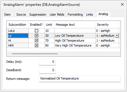

3.Configure this Alarm according to the next figure.
Analog Alarm configuration
4.Repeat the previous step for the other Measurements on the Transformer, adapting limits and alarm messages as needed.
