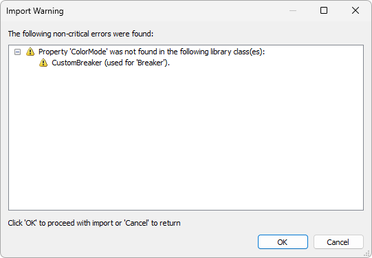

In the case of selecting classes that do not follow one or more non-critical requirements of properties or Terminals, the import process is not interrupted, but the warning message on the next figure is displayed.
Warning message when selecting improper classes to import
Selecting a custom class that does not follow one or more non-critical requirements for a device, when this device is not used in the current electrical model, does not prevent the import process.

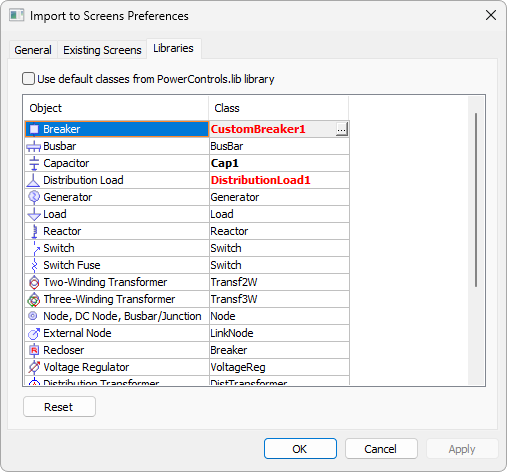

In both cases, the Import to Screens Preferences window highlights these classes to show which classes are improper, according to the next figure.
Examples of custom classes
In the example of the previous figure, the CustomBreaker1 class is named after a Breaker's default class but does not contain the required properties, therefore the class name appears in red. The DistributionLoad1 class does not contain one or more properties required for a Distribution Load, therefore the class name appears in red and bold. The Cap1 class, on the other hand, contains all properties required for a Capacitor, therefore it appears in bold to indicate a custom class.
