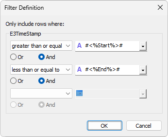

6.In the E3TimeStamp field, create a filter according to the specification on the next figure.
Filter for the E3TimeStamp field
