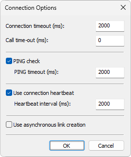

The Servers and connection options group contains an Advanced option, which allows performing specific connection configurations among Domains, using the window displayed on the next figure.
Connection Options window
The options on this window are described on the next table.
Available options on the Connection Options window
Option
Description
Connection timeout (ms)
This option controls the maximum time a Client Remote Domain waits to establish a REC connection with the E3 Server of the Server Domain. Its goal is the same as the ConnectionTimeout key, configurable using E3 Tweak. Default value for this option is 2000 ms
Call time-out (ms)
This option controls the maximum time a Client Remote Domain waits for the return from a call to a Server Domain. If this time is exceeded, this connection is closed by the client, even if the limits established by the PING check and Use connection heartbeat options are not exceeded yet. The default value for this option is 0 (zero), which disables this limit time
PING check
This option allows that, using a check on network integrity, a Remote Domain checks if the Server replies within a time-out. If there is no answer, for any reason, that computer is considered offline or turned off. This check, if enabled, occurs before the connection, avoiding an attempt to connect to an unavailable computer, and while the connection is active, forcing an immediate disconnection
PING timeout (ms)
Value, in milliseconds, for a network integrity check. The default value for this option is 2000 ms
This option allows that, using a REC protocol mechanism, the Client Remote Domain checks if the Server keeps the connection alive, waiting to send periodic heartbeat messages, even if there is no other communication to perform. If double the time of the configured heartbeat is exceeded, with the Client not receiving any message from the Server, then the Server is considered on failure or offline, forcing an immediate disconnection
Heartbeat interval (ms)
Value, in milliseconds, of the heartbeat interval. The default value for this option is 2000 ms
Use asynchronous link creation
If this option is selected, Links are created in parallel among several Domains and the result of that operation is sent asynchronously, as each Server replies. The advantage of this option is that it does not lock E3 Server's general Link handling. Only operations of that same Domain can be locked if the Link creation lasts too long, which may happen on slow networks. NOTE: This option is not available for versions prior to 3.2, and applications developed in previous versions fail with an error code 8004F108 (incompatible REC version). The default value for this option is not selected
NOTE
Deselecting the PING check and Use connection heartbeat options simultaneously turns detection of connection failures extremely slow, in case the Server fails. It is recommended that these options always remain selected.
