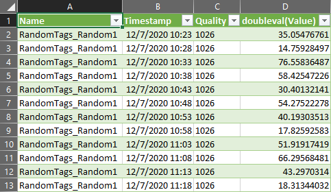

To return data from the RandomTags_Random1 variable in the period between 10:23 and 11:23 of 12/07/2020, with a timezone of -3 (minus three) hours and interpolated at every 5 (five) minutes, use the next statement.
SELECT Name, Timestamp, Quality, doubleval(Value) FROM
EpmQueryAggregateFunction(-3, '2020-12-07 10:23:00', '2020-12-07 11:23:00',
300000, 'Interpolative', 'RandomTags1')
EpmQueryAggregateFunction function
