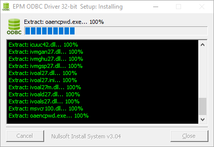

2.The window on the next figure is opened, starting the installation process previous to opening Setup Wizard.

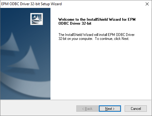

3.After this first process, the Setup Wizard window open, as shown on the next figure.
Setup Wizard initial screen
4.Click Next to proceed.

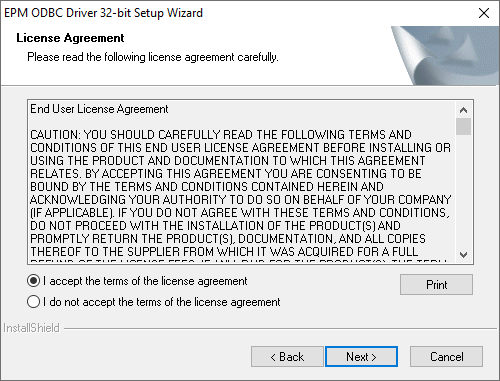

5.If users agree with the license agreement, select the I accept the terms of the license agreement option and click Next to proceed with the installation.

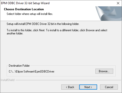

Selecting an installation folder
6.In this step, if users want to change this Driver's installation folder, click Browse and select a destination address. Otherwise, click Next to proceed.

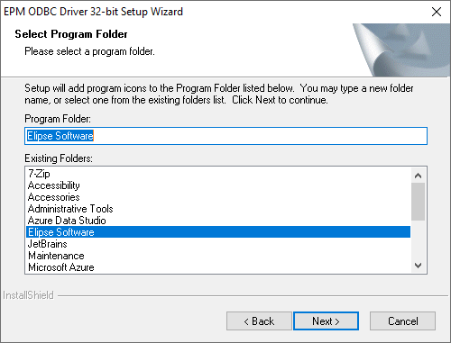

7.The installer adds programs to a folder on Windows Start menu. The default is the folder Elipse Software, which is recommended, but users can also select another folder or create a new folder. Finally, click Next to go to the next step to review all settings.

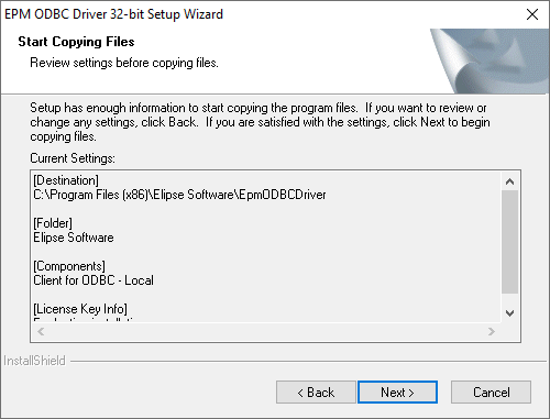

Reviewing installation configuration

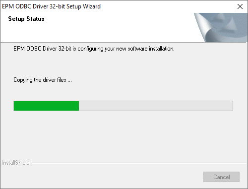

8.If all installation settings are correct, click Next to effectively start the installation. Otherwise, click Back to review those settings.
Installation progress
9.If the installation is successfully finished, the installer goes to the last step of the Setup Wizard.

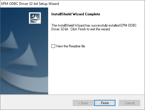

10.If needed, select the View the Readme file option to open a file with this Driver's configuration guide when quitting the installer. Click Finish to close the installer.
Installation process completed

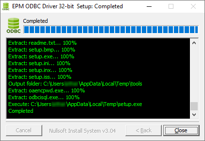

11.On the installer's initial window, click Close.
