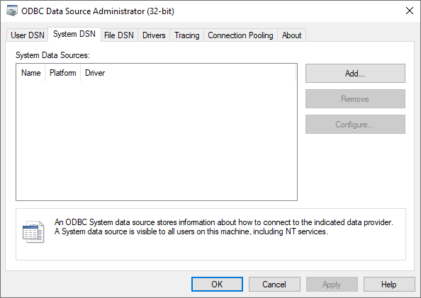

1.By using the Windows Start menu, open the application ODBC Data Sources (32-bit).
2.Select the System DSN tab.
System DSN tab
3.Click Add to add a new ODBC data source.
Adding a new data source

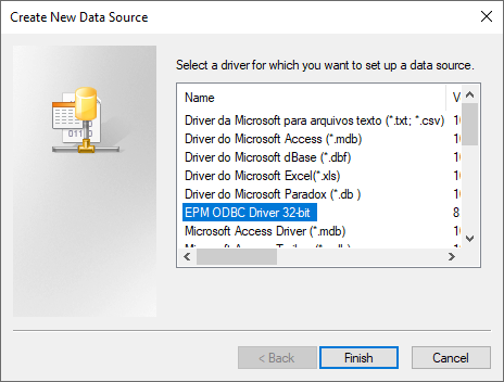

4.On the Create New Data Source window, select the Driver corresponding to the installation and click Finish to create the data source.

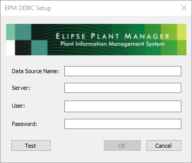

5.When creating a data source of type EPM ODBC Driver, the EPM ODBC Setup window on the next figure is displayed.
6.The configuration options on this window are described on the next table.
Configuration options on the EPM ODBC Setup window
Option |
Description |
Data Source Name |
Data source's name |
Server |
EPM Server address |
User |
User name used as a connection credential with the EPM Server |
Password |
User's password used as a connection credential with the EPM Server |
Test |
Click to test the connection with the EPM Server |
7.If the connection was configured correctly, click OK to create the data source.

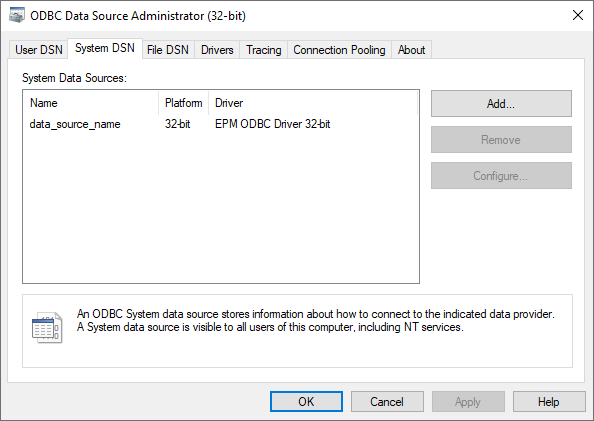

8.After finishing the creation of the data source, it appears on the System Data Sources list. If the EPM ODBC Driver's data source was created and tested successfully, click OK to close the application.
List of data sources
9.If users want to change any configuration, select the data source and click Configure to open the configuration window again.
10.If users want to remove this data source, select it and click Remove and then click Yes on the next dialog box to complete this operation.
