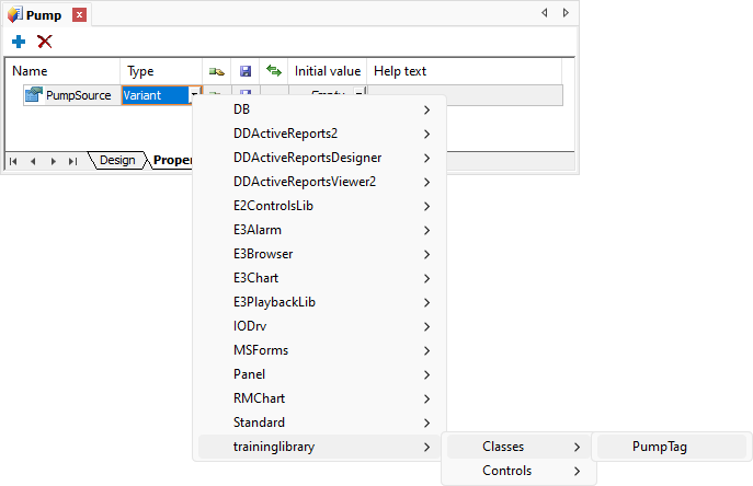

5.Create a Property called "PumpSource", with a PumpTag type (the XObject created previously).
PumpTag-type Property

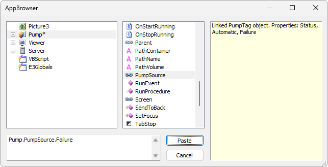

7.For the Failure Failure figure to appear only when this valve is on failure, create a Simple Link between the Visible property of this object and the Failure Property:
•Open the Properties Window of the figure representing a wrench and select the Links tab
•Select the Visible property and, using AppBrowser, select the PumpSource Property of the Pump object
•Type, after the PumpSource property, the property of the PumpTag object. In this case, Failure
AppBrowser
AppBrowser

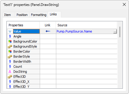

9.In the Text under the valve, the linked PumpTag object's name must appear. Create a Link between Display's Value property and the Pump.PumpSource.Name property.
Value property of the Text object

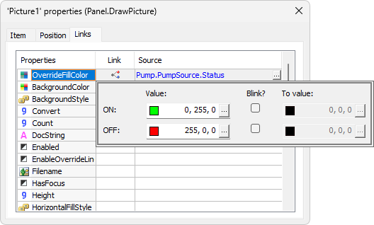

10.When the Status Property is in True, this pump's color must be green and, when this Property is in False, this pump's color must be red. On the Links tab, create a Digital Link between the OverrideFillColor property and the Status Property.
