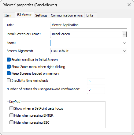

On the Viewer tab of Properties Window, Viewer's visual settings are configured.
E3 Viewer tab

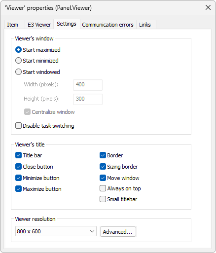

By using the Settings tab, users can configure Viewer's window, title, and resolution.
Settings tab

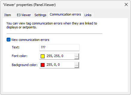

On the Communication Errors tab, users can define a pattern so that Displays and SetPoints of the whole application indicate communication errors.
