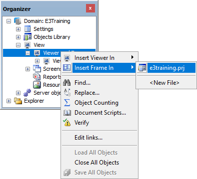

1.Right-click the Viewer and Frames item and select the Insert Frame in - E3Training.prj option.
Insert Frame In option

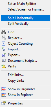

2.On Frame's viewing area, right-click it and select the Split Horizontally option, according to the next figure.

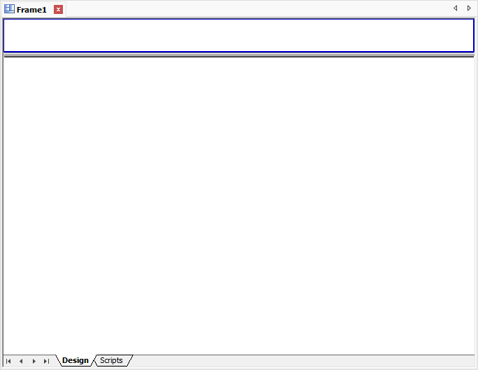

3.Place the bar about 10% of this Screen, from its upper limit, and click to fix its position.
Position of the upper bar

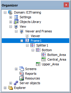

8.Name these Splitters as "Central_Area" and "Bottom_Area", respectively.
Frame Splitters
Frame Splitters

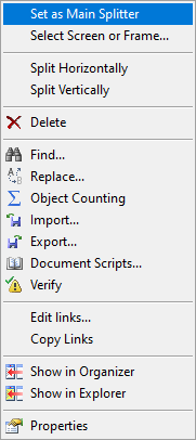

9.Configure the Bottom_Area Splitter as Main. This forces Elipse E3 to comply to Splitter's size and the remaining Screen is the Central_Area Splitter's size. Right-click the Bottom_Area and select the Set as Main Splitter option.
