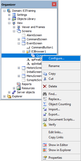

11.Open the configuration window of the E3Browser's Query object. This can be performed by right-clicking the object and selecting the Configure item or using the Query tab of E3Browser's Properties Window.
Configure a Query

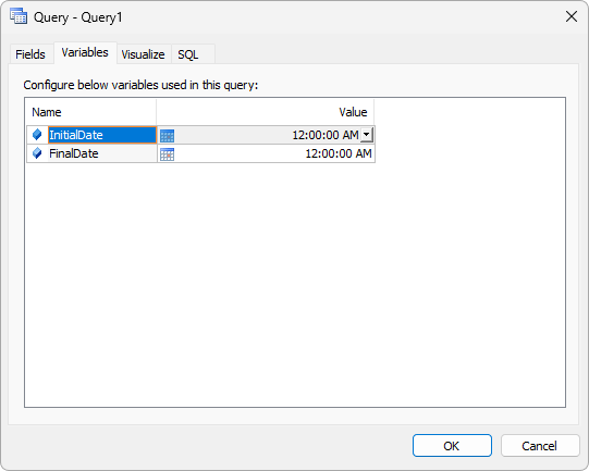

14.Type an initial value for these variables on the Variables tab.
Initial values for the filter
