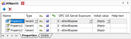

In addition to XControls and XFolders, users can create a data library, called XObject. With this library, users can define a data structure executed on the Server. Such structure can perform calculations, Links, communication, alarm verification or historical storage, among other tasks, regardless of having any graphical interface (Elipse E3 Viewer) open or executing at that moment.
Properties tab of an XObject
