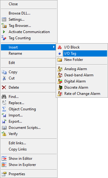

1.Right-click an I/O Driver and select the Insert - I/O Tag option.
Inserting an I/O Tag
