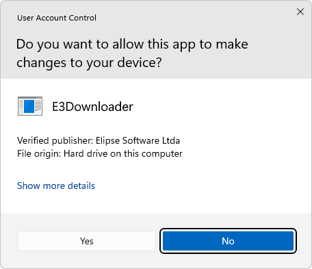

During server's first access, Internet Explorer starts installing components, in case they were not previously installed, as explained at the beginning of this chapter. This component is signed by Elipse Software, and users must accept the installation to start the necessary configurations.
WebViewer Installation
