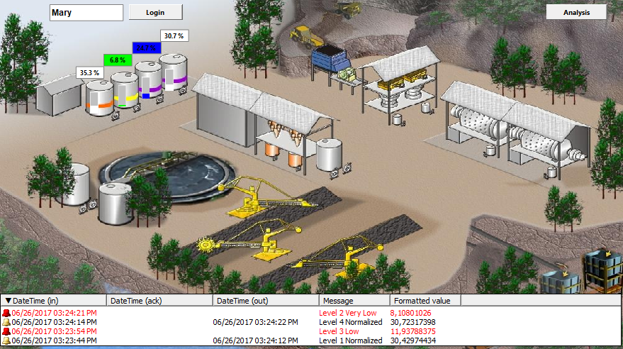

A mining company wants to monitor the levels of a few tanks. The equipment has not been decided yet, but it must display information about four levels.
The sector manager wants to view data in a user-friendly way, so they asked to develop a supervisory application with the following requirements:
•Simulate values for four levels of the equipment on failure, with values ranging between 0 (zero) and 100
•The main Screen must contain an image of the mining site
Image of the mining site
•Above each tank, view its respective level using a bar
Tank level
Tank level
•Display the level value on the Screen formatted with its engineering unit as "%", one decimal place, and obeying the colors on the next table
Level colors
Minimum
Maximum
Color
90
100
Red
70
90
Yellow
30
70
White
10
30
Blue
0
10
Green
•Display on screen the alarms of all levels, according to the next table
Alarm limits
ALARM
LIMIT
HiHi
90
Hi
70
Lo
30
LoLo
10
•On the main Screen, users must be able to identify the logged-in user
•A user belonging to the Maintenance group MUST NOT acknowledge alarms

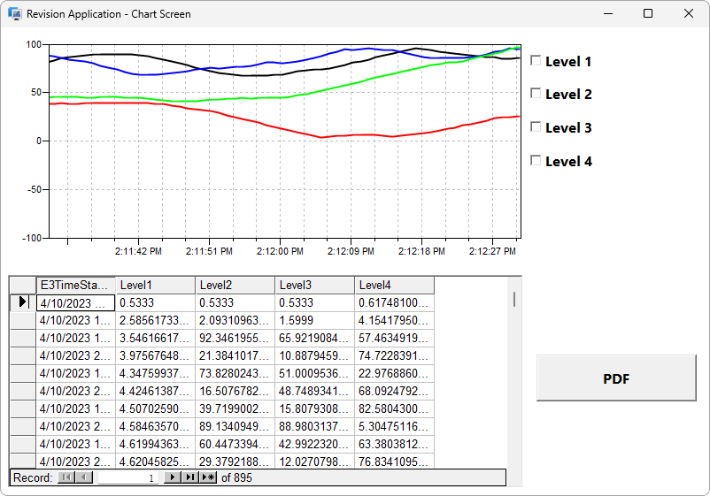

•On a second Screen, users must be able to view those four levels on a chart, where they can select, using buttons, which information to display simultaneously
Level chart
Level chart
•Store level data at every two seconds on a database
•View data stored on a database as a table, on the same chart Screen
•A report with the level data stored on the database must be exported to PDF format
