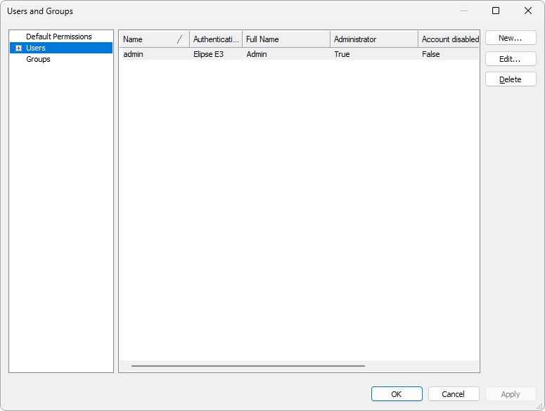

UserAdministration([PosX], [PosY], [ShowMergeErrorsOnExit], [MergeDetails])
This method opens a dialog box that allows editing a list of Server's users. The available functions are the following:
•Display a list of all users
•Delete users (the current user cannot be deleted)
•Add and edit users
•Edit settings of a user
•Change a user's password
•Change other user's data, such as login and name
This method contains the following parameters:
•PosX: Optional parameter indicating the position, in pixels, of the dialog box relative to the left margin of the window
•PosY: Optional parameter indicating the position, in pixels, of the dialog box relative to the top margin of the window
•ShowMergeErrorsOnExit: Optional Boolean parameter indicating whether a window with errors occurred during the execution of this method must be displayed. If this parameter is omitted, no window is displayed at the end of the execution
•MergeDetails: Optional output parameter containing a String with errors occurred during the execution of this method
If the PosX and PosY parameters are omitted, that dialog box's coordinate is centered on the window. If the values indicated in these parameters place that dialog box outside the visible area, those values are automatically adjusted to ensure that dialog box is visible. This method returns True if there were no problems during its execution and False otherwise.
