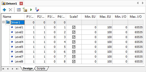

3.Insert eight I/O Tags and configure them to read addresses from 1 (one) to 8 (eight) of the Simulator.
•N1: 1 (one)
•N2: 1 (one)
•N3: 0 (zero)
•N4: From 1 (one) to 8 (eight)
4.As Elipse Modbus Simulator varies between 0 (zero) and 65535 and the variation used in the application must be between 0 (zero) and 100, enable a scale in the Tags according to the next figure.

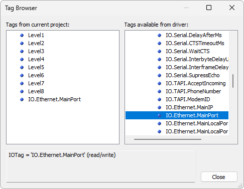

5.Open Tag Browser Tag Browser, select the IO.Ethernet.MainPort Tag, which is on the IOKit - Parameters folder on the Tags available from driver list, and drag it to the Tags from current project list.
Tag Browser
Tag Browser
