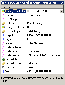

•The Property List of Elipse E3 Studio now displays the documentation of the selected property. Besides, it also displays the text "null" or "empty" italicized when a Variant property has a type VT_NULL or VT_EMPTY, respectively.
Documentation of the selected property

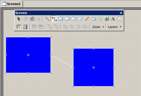

•Implemented the Connector object in the Screen editor. This object allows connecting points among two or more Screen objects. Connections among objects are displayed during drag and drop operations in the Screen editor. Besides, the implementation of native Screen objects has been revised, to ensure the correct positioning of Connection Points of objects in any combination of rotation, resizing, reflection, or distortion.
Connector object

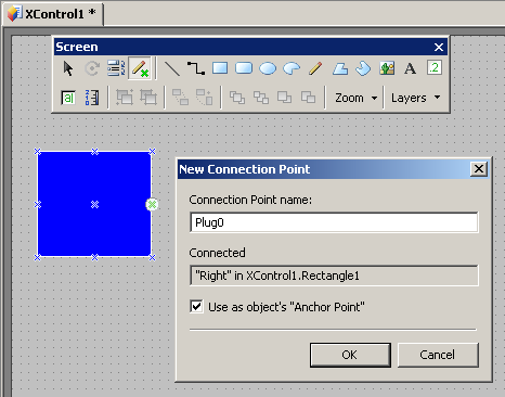

•Added a tool for editing Connection Points for XControls.
Editing Connection Points in XControls
