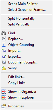

2.To create a Splitter, right-click a Frame and select a split type, Split Horizontally or Split Vertically.
Frame's split menu

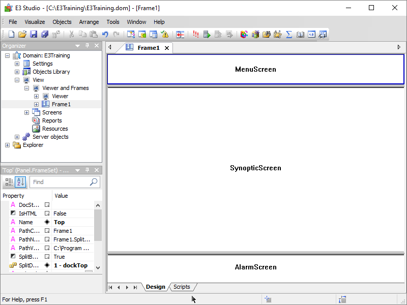

3.Drag the split bar to the desired position and then click to fix it.
Frames splitted horizontally and vertically
