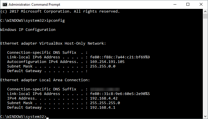

4.To discover a server's IP address, type the ipconfig command on a Windows Command Prompt, checking the IPv4 Address item.
ipconfig command

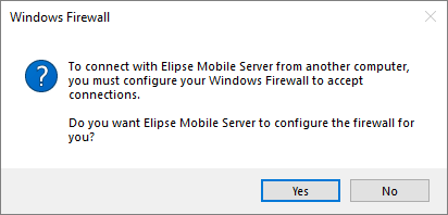

2.Click OK to check the existence of an Inbound Rule for Elipse Mobile Server. If there is no such Rule, the message on the next figure is displayed.
Message confirming settings

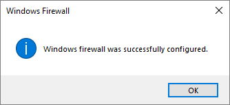

3.Click OK to create an Inbound Rule. The message on the next figure is then displayed.
Configuration finished

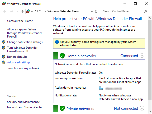

4.To check this configuration, open Windows Defender Firewall on the Start - Windows Administrative Tools menu and click Advanced Settings.

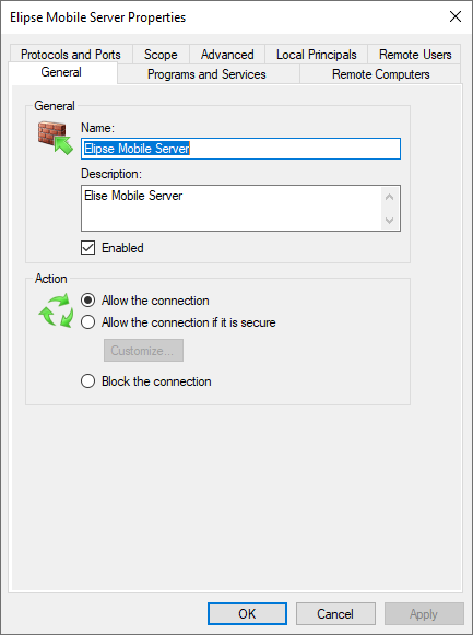

5.On the window that opens, select the Inbound Rules item in the Windows Defender Firewall with Advanced Security option and right-click the Elipse Mobile Server item to open the properties window displayed on the next figure.
Properties window of an Inbound Rule
