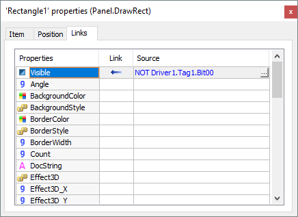

Another option is to work with Tag's Bit00 property, which is already a Boolean property, instead of working with Tag's Value property.
Using the Bit00 property
