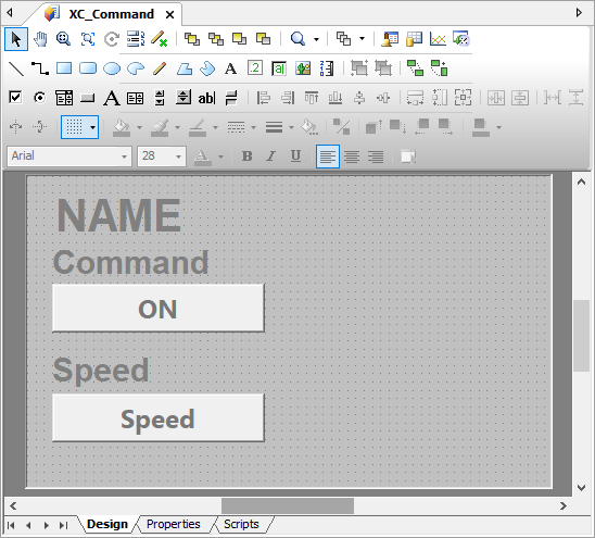

1.Insert an XControl called "XC_Command".
2.Configure it according to the next figure. It uses three Texts ("Name", "Command", and "Speed"), a Toggle Button object ("ON" and "OFF"), and a Command Button ("Speed").
XC_Command XControl

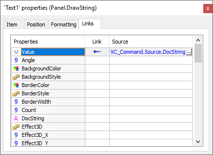

4.In the Name Text, create a Simple Link from the Value property to the DocString property of the object XO_Pump.
Simple Link with the DocString property
