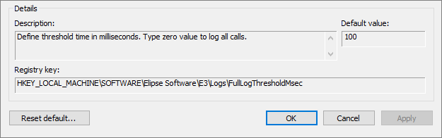

Each configuration item on this list contains, on its Value column, a Spin Button- or Combo Box-type control. If the existing value on this control is grayed, this means that this key does not exist in Windows Registry. Selecting a new value for an item automatically creates a key in Registry. Description, default value, and Registry key for each selected configuration item are displayed on E3 Tweak's window footer, as shown on the next figure.
Footer of E3 Tweak's main window

When selecting one of the configuration items on the list, the window footer automatically updates itself, by displaying the item's description, its default value, and the Registry key that must be modified or created.

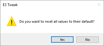

On the lower side of E3 Tweak's main window there are three options intended to confirm or not these configurations. The Apply option saves all performed changes immediately. The OK option saves all performed changes and closes E3 Tweak. The Cancel option closes E3 Tweak's main window, without saving these changes. In addition to these options, there is also a Reset Default option, which deletes all keys in Windows Registry, returning all items back to their default values. This option requires a confirmation for the operation, which can be undone by clicking Cancel on E3 Tweak's main window, if needed.
Dialog box to confirm the Reset Default option
