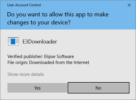

During server's first access, Internet Explorer starts installing components, in case they were not previously installed, as explained at the beginning of this chapter. This component is signed by Elipse Software, and users must accept the installation to start the necessary configurations.
WebViewer Installation
After installation, WebViewer is opened in Internet Explorer, and viewing server's application. Next time it is not necessary to install these components again, and connection is faster.
