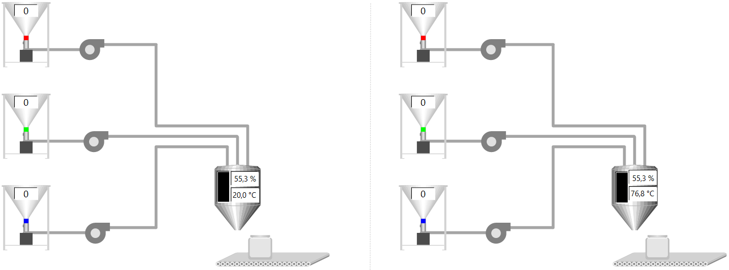

When combining the amounts of red, green, and blue, a new ink is then created in a tank. This ink is placed in a bucket that moves through a conveyor belt. Pumps, temperatures, and levels are monitored during this process.

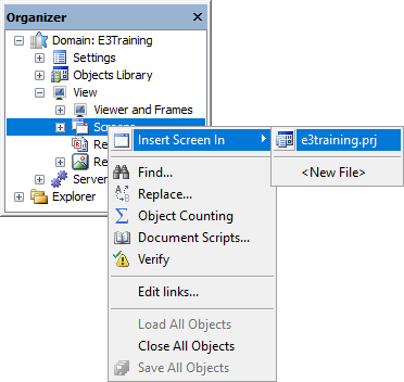

1.Right-click the View - Screens item and select the Insert Screen in - E3Training.prj option.
Inserting a Screen

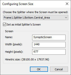

2.Select the Set as initial Splitter's Screen option and, in the Name field, type "SynopticScreen". Configure this Screen to open on Central_Area Splitter.
Configuring as initial Screen
