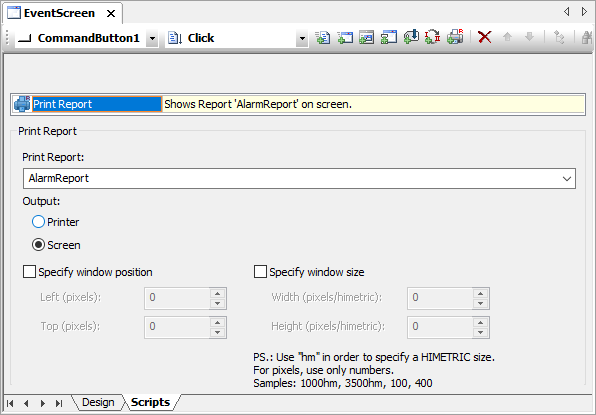

1.To view this Report at run time, copy the Query button from the EventScreen to create a new button labeled "Print".
2.On the Click event, create a Print Report-type Pick
3.In the Print report field, select the AlarmReport item.
4.In the Output option, select the Screen item.
5.Execute the application and test this new functionality.
