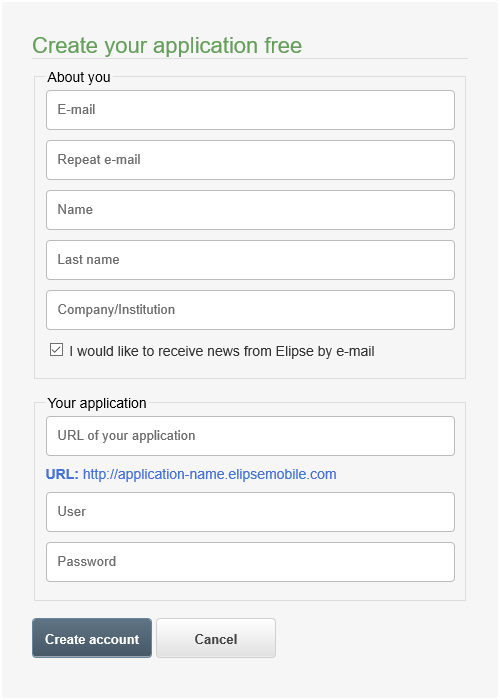

1.Go to www.elipsemobile.com and, if not yet available, create an account by clicking Try It Free.
2.Fill in your data in the About you group and, in the Your application field, type a name for this application. This name is used to complete the access URL.
Creating an account and an application

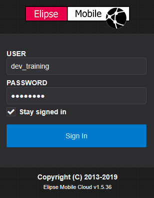

4.Click Go to administration panel.
5.Select the application previously created and type the user and password used to create this account.
User and password of the application

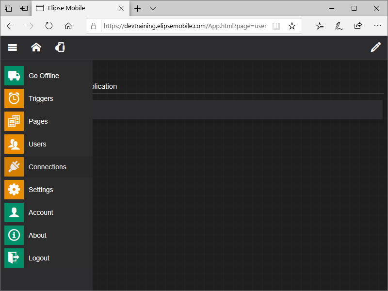

6.Click the main menu
on the top left corner and select the Connections item.
Connections item

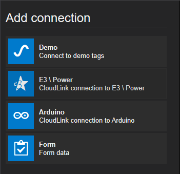

7.Add a new Connection and select the E3\Power item.
E3\Power Connection

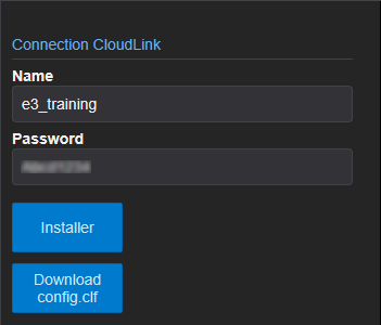

8.Type a name and a password for this connection and save this configuration.
9.Click Installer to download Elipse CloudLink installer.

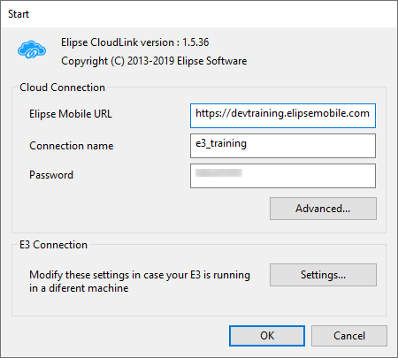

10.Install this software and click Download config.clf. Open this file and inform the connection name and password created previously.
Elipse CloudLink configuration

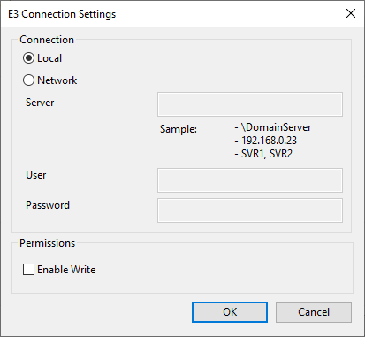

11.Click Settings to define whether the E3 application is executing locally or on a network machine. In the Permissions item, select the Enable Write option to allow writing permissions.
Settings window

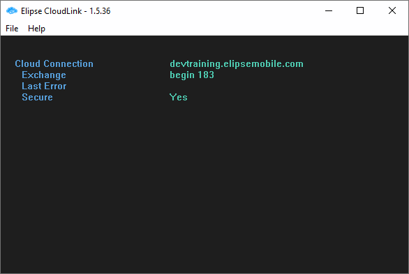

12.After configured, Elipse CloudLink is executed.
Application executing

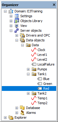

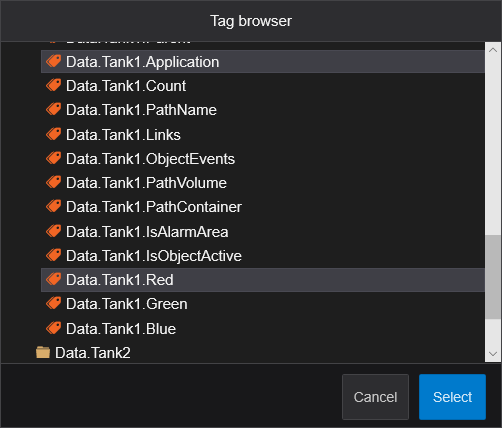

16.In this control, configure the amount of red from Tank1 when accessing Internal Tag Red on Folder Tank1.
Internal Tag
17.Click Tag
to access the Internal Tag Red, according to the next figure.
Selecting a Tag in the application
