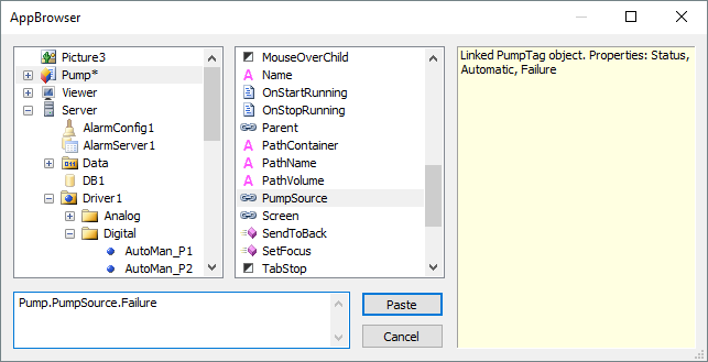

figure to appear only when this valve is on failure, create a Simple Link between the Visible property of this object and the Failure Property:
•Open the Properties Window of the figure representing a wrench and select the Links tab
•Select the Visible property and, using AppBrowser, select the PumpSource Property of the Pump object
•Type, after the PumpSource property, the property of the PumpTag object. In this case, Failure
