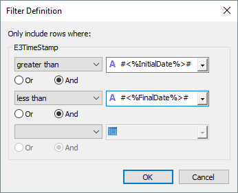

12.On the Filter column of the E3TimeStamp field, click Configure Filter
13.For users to select the initial and final date, query variables must be created. Configure the filter according to the next figure.

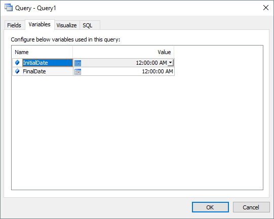

14.Type an initial value for these variables on the Variables tab.
Initial values for the filter
