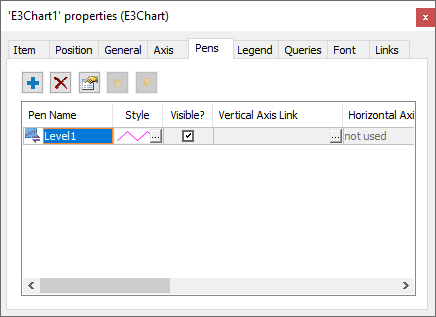

Option to add an Automatic Pen
2.Change the name of this Pen to "Level1".
Changing the name of a Pen

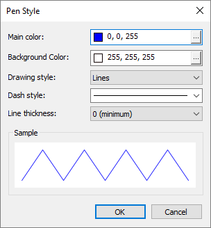

3.On the Style column, click
to open the Pen Style window and select a color and a line type.
Pen Style window

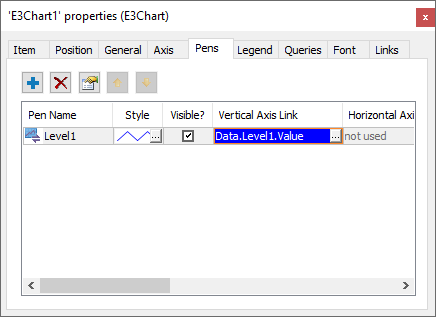

4.On the Vertical Axis Link column, select the Level1 Tag in Server - Data.
Vertical Axis Link option
