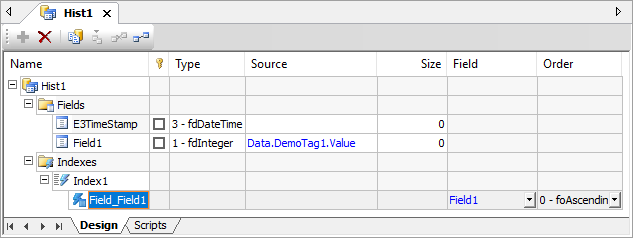

To create an index, right-click a Historic and select the Add - Indexes option to add an Indexes object, if it does not exist yet. Right-click the Indexes object and select the Insert - Historic Index option. On the window that opens, select one of the available fields. After creating an index, users can change the the field on the Field column and its sorting order, ascending or descending, on the Order column, as shown on the next figure.
Indexes object in a Historic
