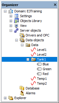

1.On Data folder, create a Data Folder named "Tank1" and insert three Internal Tags, "Red", "Green", and "Blue".
Tank1 Folder

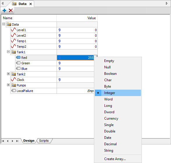

2.Configure the initial value of those three Tags to Integer.
Selecting a data type

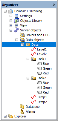

3.Create a copy of Folder Tank1 to create Folder "Tank2".
Data Folders
NOTE |
Users can use the shortcut keys CTRL + C and CTRL + V to copy Tank1 Folder and then paste it on Data Folder. |
