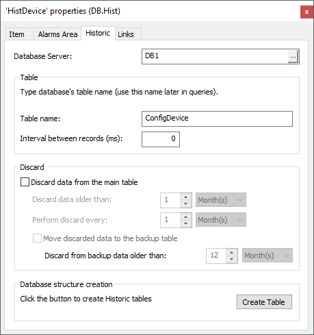

7.Open the Properties Window Properties of the Historic object of the Historic object and configure it to store data on the ConfigDevice table of the Database, storing a new record at each 0 (zero) milliseconds.
Historic's database configuration
8.Generate the table's structure.
