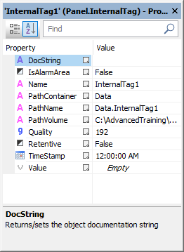

The type of an object can be viewed on the title bar of the Properties List.
Rectangle object (DrawRect)
Internal Tag object (InternalTag)
