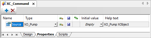

3.Create the Source Property to access the Properties of the XObject XO_Pump.
Source Property

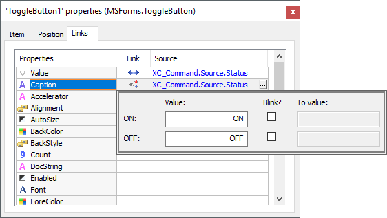

5.In the Toggle Button, create a Bidirectional Link from the Value property to the Status Property of the XObject XO_Pump to change a pump's status. In the Caption property, create a Digital Link to change the text on the Command Button depending on the value of the Status Property.
Links between Value and Caption properties

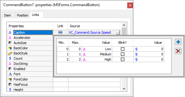

7.In Toggle Button's Caption property, create a Table Link to change the text of the Command Button according to the value of the Speed Property.
Link between Caption and Speed properties

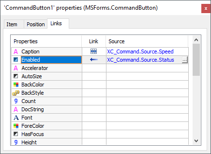

8.To disable a change in speed if the pump is turned off, create a Simple Link from the Enabled property to the Status Property.
Link between Enabled and Status properties
