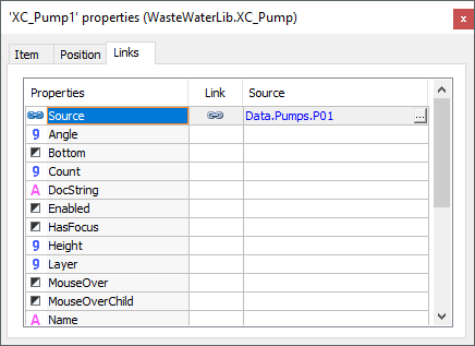

3.Link the XC_Pump XControls of the Screen with the XObjects created.
Link with XObjects
