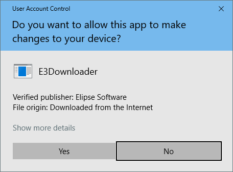

Security warning
Security warning
When a user confirms that security warning, the plug-in is installed. This component is signed by Elipse Software, and users must accept its installation to start all configurations needed.
In the next access, users do not need to install the components again, and the connection time is faster.
