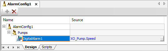

Every pump must show when it is turned on or off.
1.Insert in the XObject XO_Pump an Alarm Configuration object.
2.In the AlarmConfig1 object, insert a new Area named "Pumps".

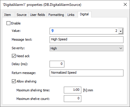

3.In the Pumps Area, insert a Digital Alarm for the XO_Pump.Speed property.
Digital Alarm
4.On the Digital tab of this Alarm, configure the Value option to 2 (two) and the Alarm messages as desired.
Configuration of the Digital Alarm
NOTE |
To change the Value option to 2 (two), change this option's data type to Integer. |
