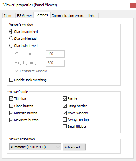

Using the Settings tab, users can configure Viewer's window, title, and resolution.
Settings tab
Settings tab
Each option on the Settings tab has a corresponding property. The available options are described on the next table.
Available options for Settings tab
Option
Description
Start maximized, minimized, or windowed
Determines how a Viewer's window starts. This option is equivalent to Viewer's WindowStyle property, and the available options are 0 - Maximized: Screen starts maximized, 1 - Windowed: Windowed style, that is, Screen's height and width are configurable, or 2 - Minimized: Screen starts maximized
Disable task switching
Disables window switching. This option is equivalent to Viewer's DisableTaskSwitching property. This option can be modified at run time by using the Frame's SetDisableTaskSwitching method
Title bar
Enables a title bar. This option is equivalent to Viewer's TitleBar property
Close button
Enables a close button. This option is equivalent to Viewer's CloseButton property
Minimize button
Enables a minimize button. This option is equivalent to Viewer's MinimizeButton property
Maximize button
Enables a maximize button. This option is equivalent to Viewer's MaximizeButton property
Border
Enables a border around Viewer's window. This option is equivalent to VIewer's WindowBorder property
Sizing border
Indicates if the window can be resized. This option only works if the Border option is selected. This option is equivalent to Viewer's WindowResizable property
Move window
Indicates if the window can be moved. This option is equivalent to Viewer's WIndowMovable property
Always on top
Indicates if the window must be always on top of other windows. This option is equivalent to Viewer's WindowStayOnTop property
Small titlebar
Enables a small title bar on the window. This option only works if the Title bar option is selected. This option is equivalent to Viewer's WindowSmallTitle property
Viewer resolution
Selects a Screen resolution. Possible values are 640 x 480, 800 x 600, 1024 x 768, 1280 x 1024, 1600 x 1200, or Automatic (based on the computer's current resolution)
Advanced
Opens a window for advanced settings, described next

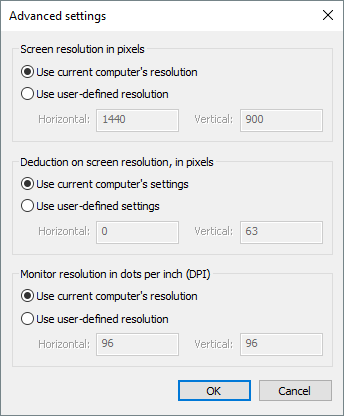

By clicking Advanced, the following window then opens.
Advanced settings
Advanced settings
The available options for this window are described on the next table.
Available options for Advanced settings window
Option
Description
Screen resolution in pixels
Allows users to select from the current computer's resolution, or from any other user-defined resolution, in pixels, in Horizontal and Vertical options
Deduction on Screen resolution, in pixels
Allows users to select the deduction on Screen's resolution from the current computer settings, or from any other user-defined settings, in pixels, in Horizontal and Vertical options
Monitor resolution in dots per inch (DPI)
Allows users to select from the current computer's resolution, or a user-defined resolution, in dots per inch (DPI), in Horizontal and Vertical options
