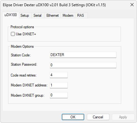

This Driver does not use [P] configuration parameters. All configurations for this Driver and for IOKit library must be performed on the configuration window of Elipse E3, Elipse Power, or Elipse Water, or on the Extra Settings option of Elipse SCADA, shown on the next figure.
uDX100 tab
uDX100 tab
Available options on the uDX100 tab
Use DXNET+
This option must be enabled if a newest PLC, which uses the DXNET+ protocol, is in use. This protocol adds 1 (one) signature byte to each communication frame, which prevents that, in case of response delays, this Driver considers as a response to a command a delayed response to a previous command, which returned a time-out error. This error may generate, among other problems, false alarms in an application. This signature byte is sent to a PLC in each request of this Driver, and must be echoed in the response of a PLC, with its value incremented at each communication. Using PLCs with a firmware that implements this protocol is highly recommended in case of communication networks that may present lengthy random delays when answering. In networks that do not present this behavior, users can avoid this problem by properly configuring a time-out
Station Code
A String with a 10-character code to be read from the modem of a PLC and checked by this Driver, right after connecting and writing this password by this Driver. If the value read from the modem of a µDX PLC does not match the value configured in this Driver, connection is interrupted
Station Password
An 8-bit number value, between 0 (zero) and 255, that represents the password to write to the modem of a µDX PLC right after connecting to this Driver. If the written value does not match the value configured in the modem of a PLC, it interrupts the connection right after writing
Code read retries
Number of attempts to read the code of a modem, in case of communication error
Modem DXNET address
DXNET address of a modem from a µDX PLC
Modem DXNET group
DXNET group of a modem
