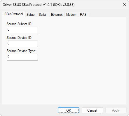

The [P] configuration parameters of this Driver are not used. All settings are performed on the configuration window. For more information about the Setup, Serial, Ethernet, Modem, and RAS tabs, please check topic Documentation of I/O Interfaces. The SBusProtocol tab, shown on the next figure, contains specific settings for this Driver.
SBusProtocol tab
SBusProtocol tab
Available options on the SBusProtocol tab
Option
Description
Source Subnet ID
Identifier of a local sub-net, between 0 (zero) and 255
Source Device ID
Identifier of a local device, between 0 (zero) and 255
Source Device Type
Type of a local device, between 0 (zero) and 65535
