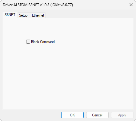

Configuration Window
This Driver's configuration window contains only one option, Block Command, on the S8NET tab, which allows it to send messages to an S8000 network.
S8NET tab
S8NET tab

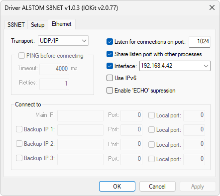

Additional configurations must be performed on the Ethernet tab, as shown on the next figure.
Ethernet tab
Ethernet tab
The options to configure on this tab are the following:
•Select the Listen for connections on port option and type the value "1024" in the corresponding field
•Select the Share listen port with other processes option
•Select the Interface option and then select a network interface with an IP address on the same sub-network of all other ALSPA controllers. This IP address must represent the device this Driver replaces as a gateway
