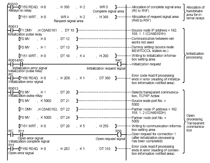

•TCP/IP Communication: Users can communicate with a device in TCP/IP mode using the Ethernet module, which can be purchased separately. For more information, please check with a manufacturer. To use this module, regarding the configuration of this Driver, enable the Use ET-LAN unit option on the Mewtocol options tab of this Driver's configuration window in Elipse E3, Elipse Power, or Elipse Water or on the extra configuration window in Elipse SCADA, and specify the address that identifies this Driver on a network in the Computer Station Number option. The configuration of a device, on the other hand, must be performed using the programming software loaded and executed in that device. For more information, please check the programming manual and the technical manual of the Ethernet module for examples of configuration applications in relay language, shown on the next figure
Example of an application for communication with an FP2-LAN module (ET-LAN unit)

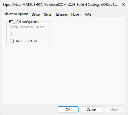

Another possible configuration, already used by some users, is using a serial communication encapsulated in TCP/IP without an Ethernet module. In this case, deselect the Use ET-LAN unit option and configure this Driver for communication in TCP/IP mode. To do so, use a TCP/IP to serial converter on the device side.
