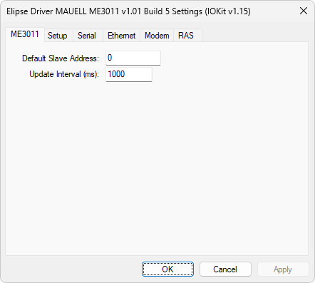

The [P] configuration parameters of this Driver are not used. All settings are performed on the ME3011 tab of the configuration window, shown on the next figure.
ME3011 tab
ME3011 tab
Available options on the ME3011 tab
Option
Description
Default Slave Address
Default address of a Slave in the network. This value is used if the N1 or B1 parameter of a Tag is equal to 0 (zero)
Update Interval (ms)
Time interval in which this Driver performs a transfer of events from the internal memory to an application. This value must be at least equal to 1000 ms
