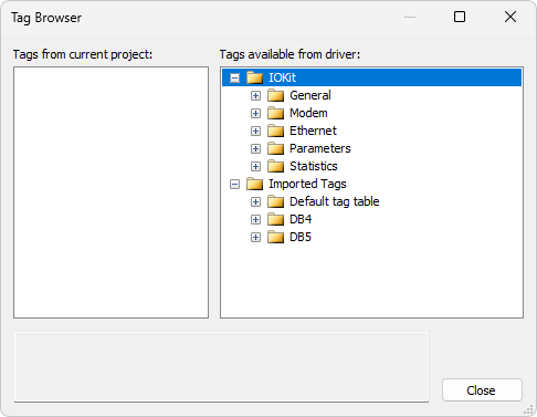

Tag Browser window
Tag Browser window
The Tags from current project list displays Tags and folders already in the current project. The Tags available from driver list displays a tree with Tags provided by a Driver. To create a Tag in an application, drag one of the Tags defined by this Driver to a folder on the current directory. Siemens ISO-on-TCP Driver provides the following nodes on this tree:
•The IOKit node displays Tags available on IOKit library, grouped into the following categories:
•General: Tags for general use
•Ethernet: Tags for manipulating communication via Ethernet network
•Parameters: Tags for configuring IOKit library parameters
•Statistics: Tags with communication layer statistics
•The Imported Tags node shows all Tags imported and saved on the Import Tags tab. This node only appears if there are actually imported Tags. In this case, this node contains a folder for each separate group of imported Tags. If there is a Data Block (DB), the Tags referring to variables are grouped into one folder in reference to this DB. The other Tags are grouped into folders referring to the table to which they belong. Each Tag is created with the Device field with a default value of 0 (zero)
