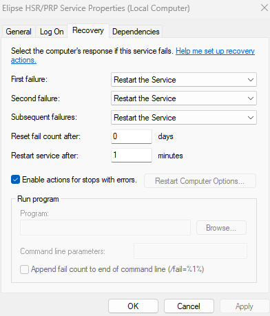

For an installation in a production environment, it is highly recommended that the service is configured with Automatic Startup and also automatically restarted in case of failure. Starting from version 1.0.0.2 of the service, if any of the network interfaces cannot be accessed for more than 1 minute, the service forces an exit with a Windows error code "Adapter Hardware Error" - code 57. It is possible to configure the service to restart automatically as follows:
General Tab: Startup Type: Automatic
fig_iec61850_prp20
Recovery Tab:
- First Failure, Second Failure, Subsequent Failures: Restart the Service
- Check the option "Enable actions for stops with errors"
- Define how many minutes to wait for the restart.
fig_iec61850_prp21
- Disable service logs.
