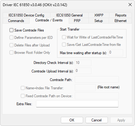

Comtrade / Events Tab
Comtrade / Events tab
Available options on the Comtrade / Events tab
Option
Description
Save Comtrade Files
Indicates whether this Driver must perform a search for files in COMTRADE (oscillations) format, saving them on the directory indicated in the Comtrade Path option
Define Parameters per IED
Indicates whether the parameters Save Comtrade Files, Delete Files after Upload, Browse Root Folder Only, Comtrade Path, Use Fixed Comtrade Path on Device, Name+Index File Transfer, and File Root Name are defined per IED and not globally for this Driver. The individual definition can be performed by writing the internal parameters of this Driver via IOKit library, as explained on topic Dynamic Configuration
Delete Files After Upload
Instructs this Driver to delete a device's file after successfully finishing the transfer
Some relays insert files in COMTRADE format on a COMTRADE folder starting at the root folder, and other relays insert these files on the root folder, indicating as part of the file name that folder, such as "\COMTRADE\File.cfg". Select this option for devices with that last behavior
Wait for Write of LastComtradeFileTime
With this option selected, this Driver waits for a writing operation with the time of the last transferred file in COMTRADE format, per IED, so that it can compare this time with the list of existing files on an IED, thus defining which file must be transferred
Save/Get Last Comtrade time from File
Gets the time of the last file in COMTRADE format transferred using a COMTRADE.LST file
Max Time Waiting after Startup
Indicates how many seconds this Driver must wait for the writing of a Tag with the time of the last file, or for the reading of the COMTRADE.LST file. If this time expires, this Driver starts searching for the first available file. If this option is equal to 0 (zero), it waits indefinitely
Comtrade Directory Check Interval
Interval, in seconds, in which this Driver requests a list of files from a device. This Driver compares the date of the last transferred file with the files on the list, and the most recent file or files are transferred
Comtrade Upload Interval (s)
In case of transferring more than one file, this Driver waits the time defined in this option to perform each transfer, to separate a specific time window for this activity. However, receiving events and sending commands are not interrupted while transferring a file
Comtrade Path
Indicates a directory where this Driver saves files in COMTRADE format
Informs that a file transfer is performed based on a root name plus an index, instead of comparing dates, which is the default behavior. That root name must be informed in the File Root Name option. For example, if an IED generates files in the format Osc1.dat/cfg, Osc2.dat/cfg, and so on, users must select this option and inform the text "Osc" in the File Root Name option
Indicates that this Driver must ignore a search for the COMTRADE folder on a device, assuming a fixed folder informed in the corresponding option
